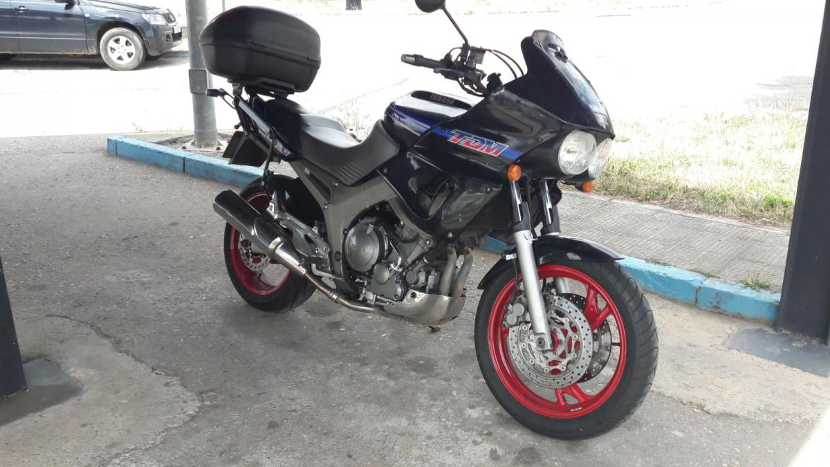

Modesto posted up a photo of his 900 wearing mk1 clothes, looked like he did a really good job. :good:

Thats pretty cool. looks like hes used the mk1 tank also.

That's a great bike Modesto has built  :badgerrock:

He did promise to come back and tell us how he didi it but we aint heard from him yet.  Be interesting to know what was involved and if he fitted carbs etc.

Yes, he's taken it further than i would have as I wouldn't bother with the back end or the seat, but what a good job!

I was still with my eyes wide open after I've read about these throttle bodies, that could be great!
I've noticed my bike in this thread, I'm writing about it on my computer, but mostly after work at night and given that English is not my mother tongue it's taking me ages, but I promise I'll keep it on going. I'll also watch this topic too!!
