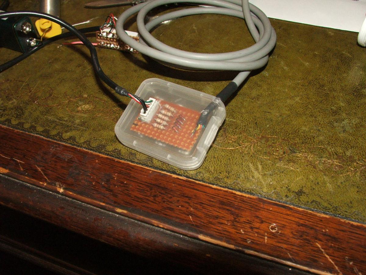

On a 4TX all you have to add to the white plastic thing is some screws if I remember correctly.  The two existing wires shown from 2nd & 3rd (or it might be 1st & 2nd, can't remember and there is some argument about it on here) can be removed - they retard the ignition in those lower gears so leave them disconnected and taped out of the way.
You do also need to make an encoding unit like JBX did.  Mine is a little strip of veroboard inside an SD card case, and I used a connector off a broken computer mouse to then connect up to the LED display.  JBX refers to 1K resistors, but according to an online LED resistor calculator you'll want 470 ohm resistors for the ebay display above.  The encoder circuit can be separate like mine or built into the display unit if you'd rather.  My pics are a bit rubbish but hope you can see what's going on.
LED array
Attached File  gearind 003.jpg   168.05KB   2 downloads
Attached File  gearind 004.jpg   135.26KB   1 downloads
Separate encoder unit
Attached File  gearind 006.jpg   173.27KB   1 downloads

Excellent thanks for taking the time to post the pics  :signthankspin:
re: the pic above - could I just solder the resistors inline and heat shrink them ?
Also where does the power come from to light the led's does that come from the gear selector or somewhere else
jbx tutorial may be a little confusing to the electrically challenged of us  :lol:

Power comes from the dashboard end (short pink wire on mine) 12v+ goes to each led then the circuit is completed when the gear selector makes the circuit to earth. You can solder the resistors in line but you still need the diodes which act to separate the channels. Without them they'll all light up. If you look closely you can see the diodes go across each line diagonally, separating each one. They act like a one-way valve, preventing current from going in the wrong direction. Hope that makes some sense.
1996 TDM850 in Yellow, Motad Nexxus, MK1 bashplate, Acerbis handguards, K&N, Xenons, Aux lamps, Bluespot calipers, Renthal 755 bars, DIY panniers, JBX-inspired gear indicator.  (Sold 2025.)
Bikes wot I have had and dun't have any more: 1983 Honda CB125TDC, 1976 Kawasaki S1C (early KH250 stroker triple), 1986 Honda VF500F2, 1992 Kawasaki KLE500.
#10 JMC
JMC
  • 265 posts
  • Location:Ireland
Posted 10 October 2018 - 11:15 pm
Yes that makes perfect sense.
So for the wiring path
gear selector >diode >resistors > minus side of led's
edit - (diode's running across)
Power from pink wire in dash to all led's
When gear is selected it completes the circuit
EDIT: looking at jbx diagram again now it's making more sense, I see what you mean about the diode's going across so I'ts finally sunk in :)

#11 CaptainSlow
CaptainSlow
  • 716 posts
  • Location:Gorleston, Norfolk
Posted 11 October 2018 - 07:53 am
I've edited this post several times after something else has clicked with me so when I eventually get to do this I'll take detailed pics and hopefully explain it in the simplest terms possible for the non elec minded people
Next I'll need to make a list of parts needed
You're getting it!  I'm not an expert either - I've drawn it out myself in felt tips to refresh my own memory, it might help!
