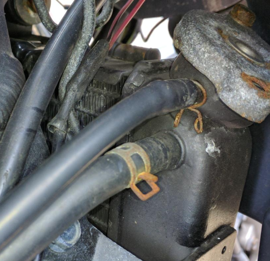

Thanks for your responses, the problem is that the water get lost from radiator, not only the expansion tank. The radiator don't have to be completly full of coolant ?
Before the water start getting out of expansion tank (and before fan start working) I see a lot of coolant bubbles (water booling) on expansion tank.
I attach some images.
Thanks!.

#5 fixitsan
  • 4,827 posts
Posted 13 August 2019 - 10:32 am
Hello and welcome. Also, you have 2 pipes connected to the top of the radiator, check to make sure they are in the correct position, the larger of the two connects to the lower fitting.  They often get swapped over after the radiator has been removed and re-fitted.
+1 check these two pipes.......Large pipe with wide clip goes to the lower connector, not the upper one. In your last photo you seem to have the pipe with the wide clip going to the top port, which is incorrect
This looks wrong. The pipe with the wide clip should go to the lower port, Yours in on the upper (non-pressurised) overflow port

Posted 13 August 2019 - 10:56 am
You are the boss!
how in the hell the seller did not notice any problem ?? I think it's really a liar.
The bike is actually like this:
Attached File  radiator.jpg   344.67KB   3 downloads
I will swap them and test this afternoon.
Big thanks!

Radiator should be full, expansion tank should have the space for expansion.
Studley & fixitsan look to be on the mark with those pipes being the wrong way round.

Had same problem, reversing pipes fixed it
Thread here
http://www.carpe-tdm...l=&fromsearch=1

I have just tested with pipes in correct position and all is right! no more water booling :)
Thanks all you brothers!
