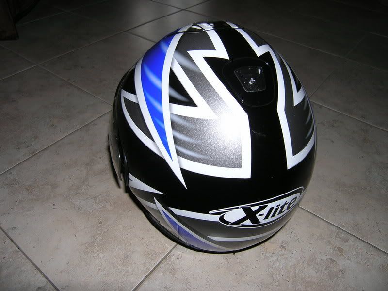

Nice suggestion re. the adaptors. Ivan. wifgeni.gif As a further thought, would it be worth using rubber grommets or O-rings, or some sort of rubbery strip between the screw positions, to preserve the flexibility of the rubber nut attachment system? Or are they already soft components you're using? I seem to recall DIY stores sell little stickon silicon "spots" as feet for ornaments etc. Might that need longer screen screws though? Is that something you already need to think about?
The mod. is like one excellent feature on my (X-lite) helmet which pops the visor forward about 3mm (see here and here). resulting in a nice breeze which doesn't bring rain in. OK, the profile is different for a w/screen, but the principle is there. The TDM screen isn't for me to look through in practical terms, and does anybody worry if the inside of the screen gets wet (as it does anyway)?
