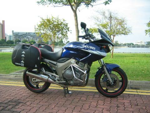

Next after H&B,i got an offer from a good friend from Kuala Lumpur selling me the Yamaha panniers..i've always wanted to have those...but its too expensive here...a pair of panniers and racks cost SGD$1800.1 side pannier able to store FF helmet.
Yamaha
Slightly wider than H&B
TDM+yamaha panniers.
Comparison between H&B and yamaha
TDM with yamaha sideracks.
Plus points.
1.looks great.
2.Your TDM will never feel left out when side by side with ST,RT,FJR..hehe
3.Looks great too without the panniers...your bikes feel naked.
Not so good point
1.Need keys to open every time
2.Lock design crappy.easy to peel the box open.
3.Freaking expensive.

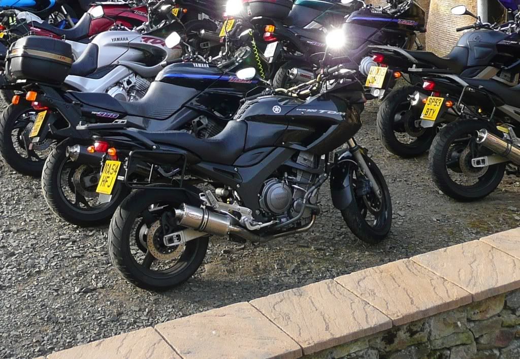

Mike have a look Here http://www.carpe-tdm...?showtopic=7925 to see my set fitted to me old TDM
good thing about the Hepco's they have ample clearance for most aftermarket exhausts

Here's i cut and paste from Hartside Man's pictures.
Don't really get what ya mean...
Anyways,the H&B racks comes with the signal lights holder...so you have to shift the signals from the rear mudguard to the side racks...its better a more nicer location than the Yamaha sideracks that comes with the signal lights holder.

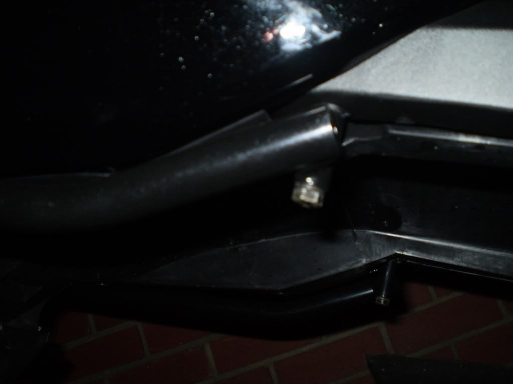

Hi HM
This picture shows the front mounting point of the existing Ventura rack I have mounted on the bike.
I'm hoping the H&B front/top mounting point is flat plate so I can modify the Ventura rack mounting point to accept the H&B as well.

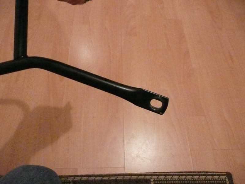

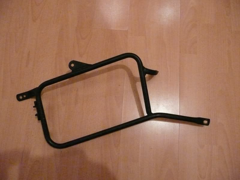

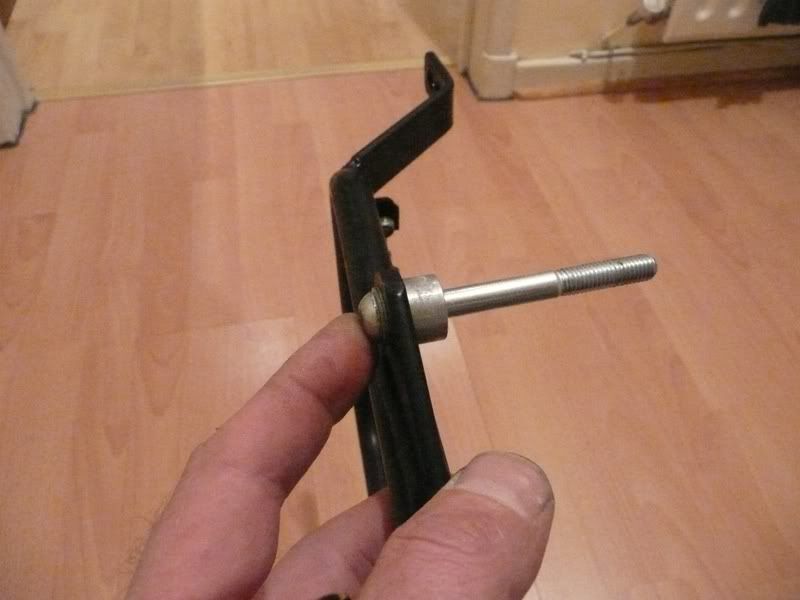

right Mike
this picture shows the whole rack bottom right is the exhaust mount , above that is the bungee mount your interested in, top middle is the mount for the grabrail bolt, top left is the indicator reposition mount (2 Holes)

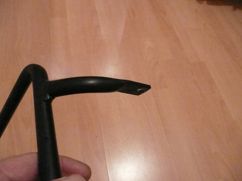

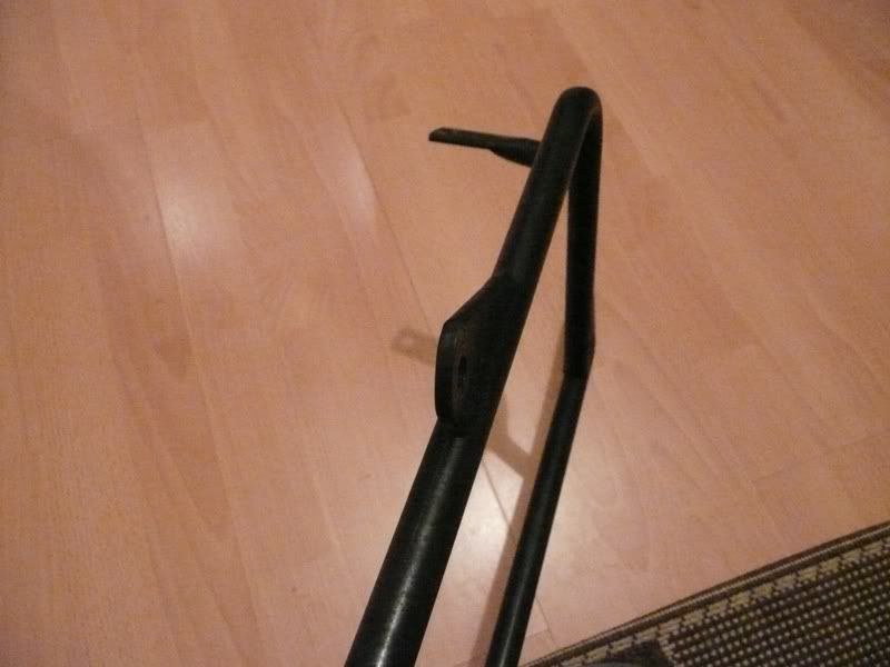

Closer view of top middle thickness and position, and the bungee mount at the back.
Bungee mount point by itself

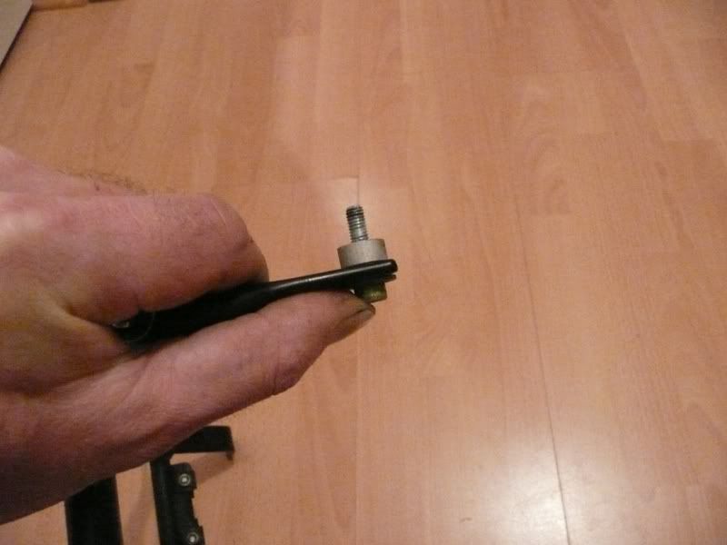

Top mount showing provided spacer and bolt
Bungee mount point showing provided spacer and bolt
lower exhaust mounting point

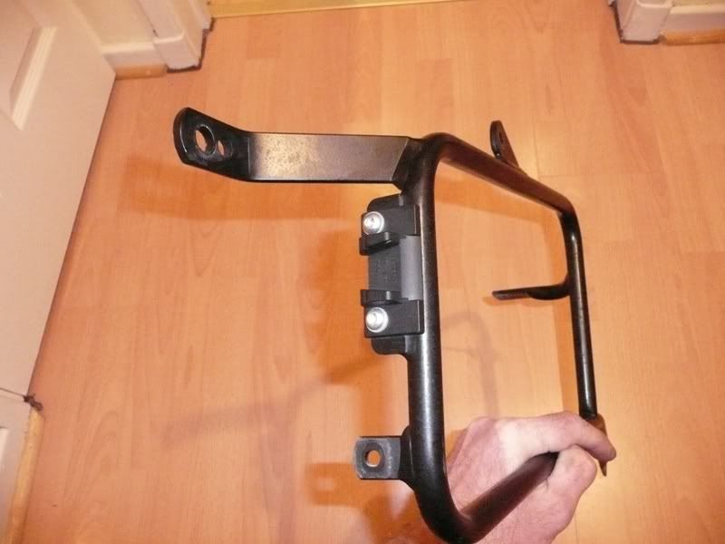

overall view showing placement and lower lug has a flat bar that passes between racks behind the rear mudguard and beneath your numberplate
Hope this helps, from your picture it would seem your going to have a tight fit on the bungee mount , the provided spacer is approx 6mm thick so if your mount boss is thicker than that it could cause you a small problem.
have you access to a metal working shop ? i am sure with a little heat and a hammer the bungee mount could be repositioned to allow you to fit both together . rolleyes.gif

Hi MarkD
Thanks so much. The pictures are exactly what I wanted.
I'm pretty handy with a hacksaw and angle grinder, so I reckon I will be able to do some cutting work on the Ventura rack and make it all fit.
Again, thankyou very much. I appreciate your efforts. You're a legend smile.gif

MarkF, I have the Nonfango hard luggage on my 900 and it is great. It is 100% waterproof, lockable and light. The topbox fits 2 FFHs(54ltr) and the panniers are 42ltr. If you want to check it out go to : http://www.flickr.co...s/73957545@N00/
There are a number of photos showing the luggage. If you want closeups let me know. I believe this system has the best aftermarket racks available.
Edited by Sparra, 17 April 2008 - 12:10 am.
