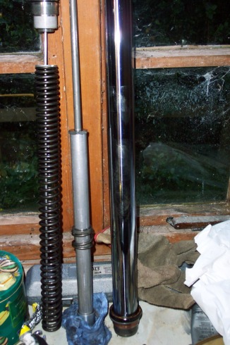

Question 1:
I assume these are the bushings. Part #'s 14 & 16 in this pic?

Q1: Yes
Q2: If you can find a method please let us know. The smaller bush (top bush) is probably reuseable but the bottom one is destroyed as the forks are seperated and the two collide. Haynes suggests that they just rest against each other, but what actually happens is the top bush rides over the bottom bush and detroys the teflon surface.
Q3:Have not needed any special tools to dismanlte. There is a pic of the components shown above. If you want detailed pics of anything particular lettuce snow.
