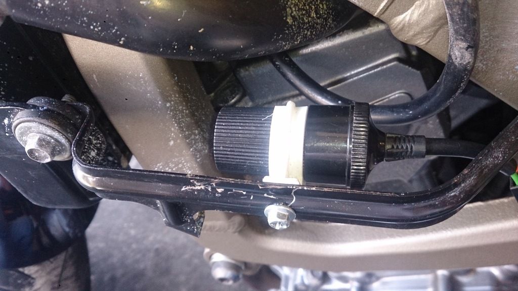

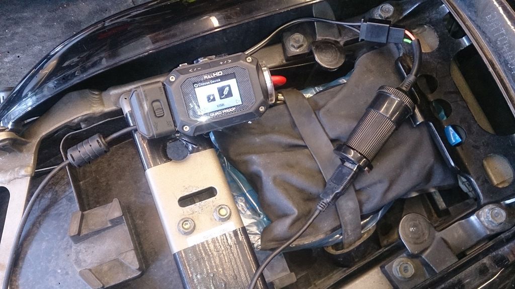

Let me join in on this thread with the USB set up I have fitted my TDM with.
My Super Tenere has two cigarette sockets and a hard wired sat nav, so i can just use a USB converter plug for all my charging, mobile phone needs.
However the recent trip to Dom's highlighted the inadequacy of the internal battery life on my sat nav, so I decided to remedy the situation on my return.

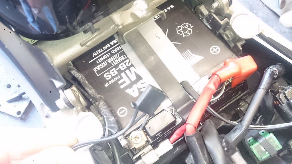

I first of all hardwired a twin female socket to my battery
using the male side of the plug to connect to a standard loose cigarette socket
This allows me to charge my mobile, go pro and other similar stuff under the seat ( with a bit of moving about of tools, etc)

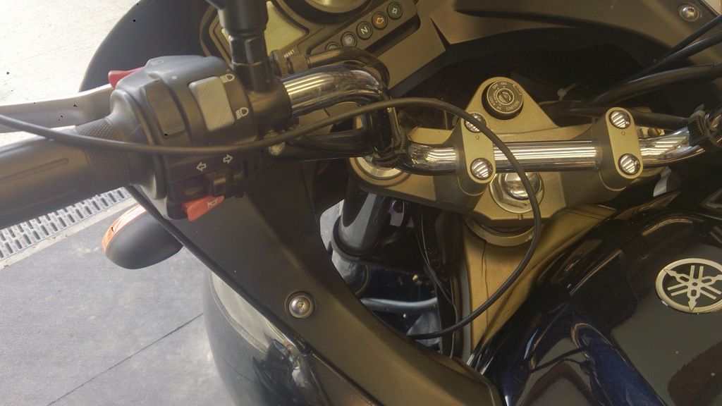

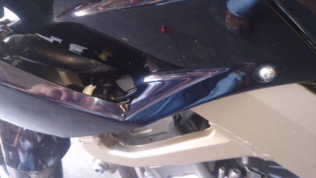

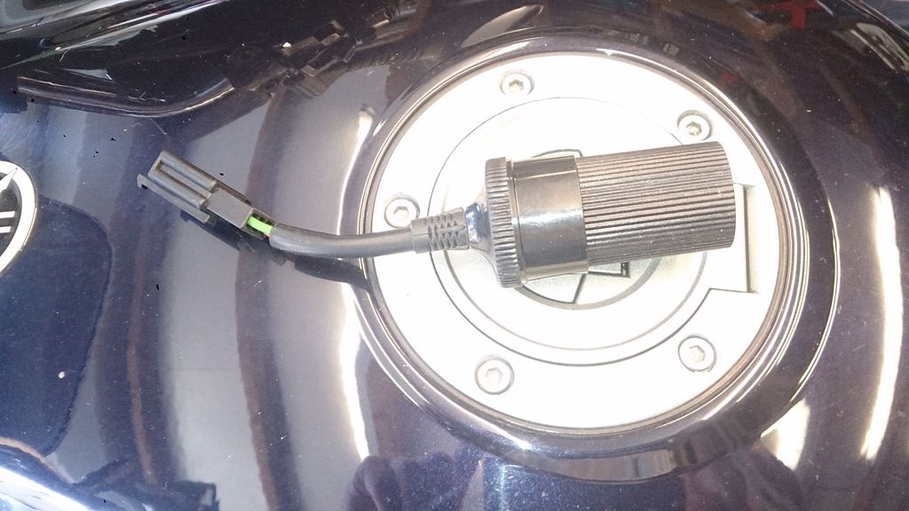

But what I really needed now was a way to charge my mobile and/or sat nav whilst on the move. In a moment of inspiration that my Uncle Heath would be proud of, I hit upon the idea of clipping the free cigarette socket to the frame with a 22mm copper pipe retaining clip. A tiny bit of trimming was required to allow the socket to clip in and out. I heated up a 8mm nut and melted it into the plastic clip to create a captive nut. I was the able to drill the radiator mounting bar and pop a bolt through to tighten the clip to the inside of it.
With the side panel reattached the wiring is neatly hidden
and the USB cable is plenty long enough to reach either my mobile or sat nav when attached to the bars
Not rocket science I admit but a nice flexible way of getting the power where I need it with the added advantage of being able to easily and quickly detach everything and hide it under the seat away from the weather and prying eyes'
