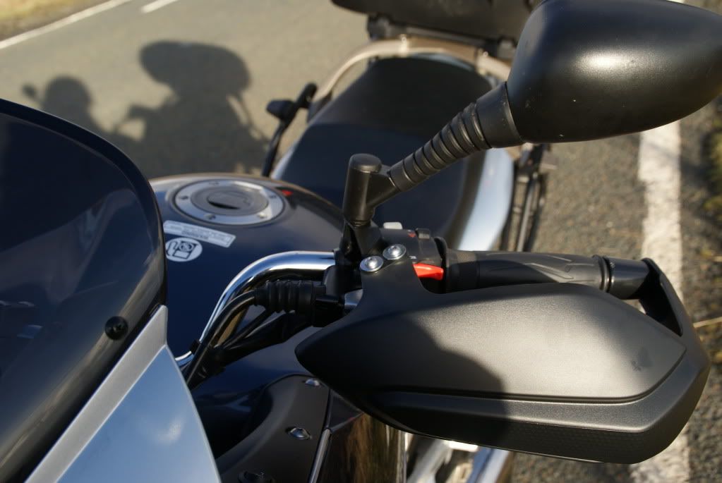

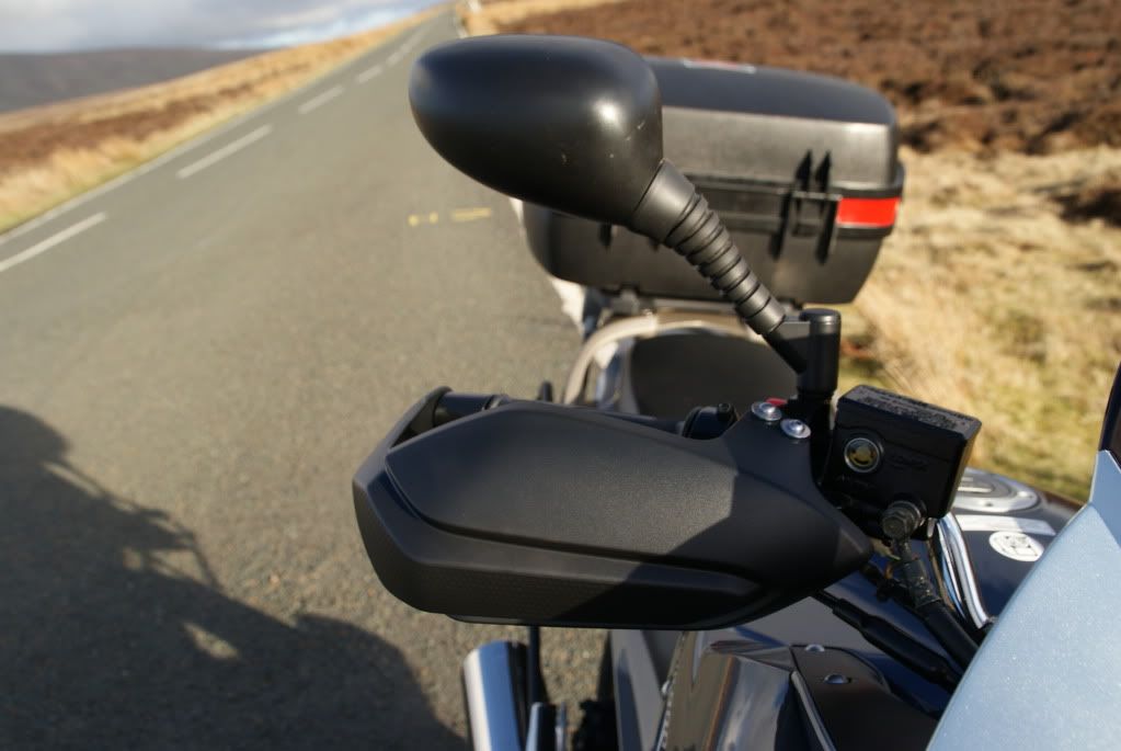

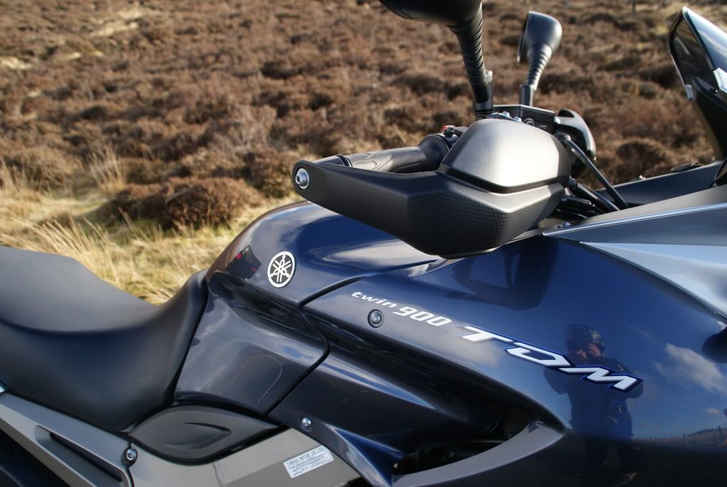

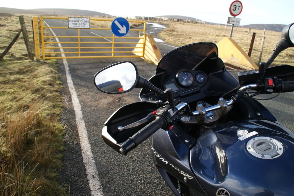

QUOTE(bsa @ Sun 2nd Jan 2011, 04:50 AM) <{POST_SNAPBACK}>
Finally got out for a spin today - and to summarise the guards - I Love Em!
Keeps the cold wind off my hand's and just feel nice riding with them on. Nice and solid even though I've only fitted them top and end (whereas the Super Ten attatches top and bottom and end). 2 bolts attach each bracket on top so fixed well and no chance of twist. Nothing touches on full lock, no touching or rubbing parts
Here's some pics....
After much trial and error fitting, I would say if I started again with the supplied parts it would only take an hour. Drill and tap the bar ends as discussed on here before. drill out the brackets that connect to mirror to 13mm, take mirror stantion apart, put back together with bracket in middle (as shown in last photo) and bolt all together. They clear the choke on the left and brake reservoir on the right easily. I did unfortunately try bending and reshaping the brackets first thinking I might be able to get them to miss the brake reservoir by attaching at the bottom of the mirror but was not possible, so I have to admit even though I tried to bend them back to original shape, my brackets are not as they were originally but I've bent them to how I want the guards to fit, height and angle wise, so you may or may not have to do this - I can't remember how they were shaped when I bought them.
Poole Motorcyles who supplid the guards can be contacted here -- http://www.poole-mot...es_Contact.html
Nice sleek look with the Super Tenere Hand Guards...
