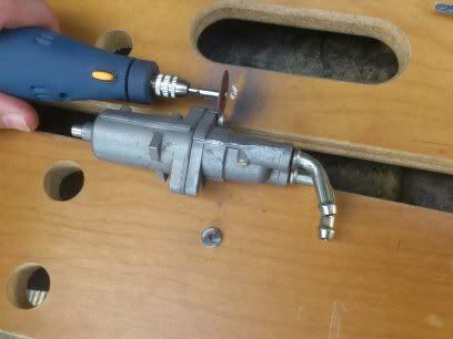

Tried to unscrew it, too tight to get anything in , spent ages cutting tools down fecking every thing I tried failed. By that time I had chewd up the screw slots , so there was no point in taking the radiator off, plus i did not have a foot long screwdrive.

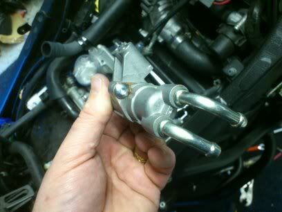

Decided to demil two slots in to use a flat screwdriver. Got one out but the other just collapsed, those screw heads are seriously tight and there is no way to stop it slipping.
so late last night I bit the bullet abd Dremil the whole head off.
Even the two side screws tore up, they are just the wrong fixting.

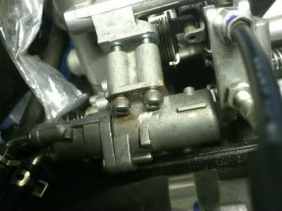

Today just went and got some M5 allen key fixings and replaced the lot.

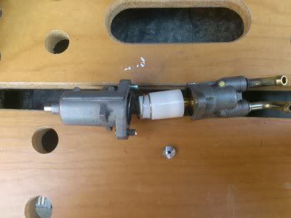

once the head is off it just springs apart, the plunger was solid and took an age to free and polish up so it moved freely.
Replacing is easy.
Why Yamaha did not use these fixings in the first place , I do not know.
I had to use this mini ratchet and the back has been cut down to fit, that is how tight it is.

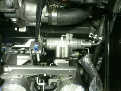

What a bloody job, its a bastard to get to and the odd thing is the position is open to all the crap that would get drawn through radiator.
