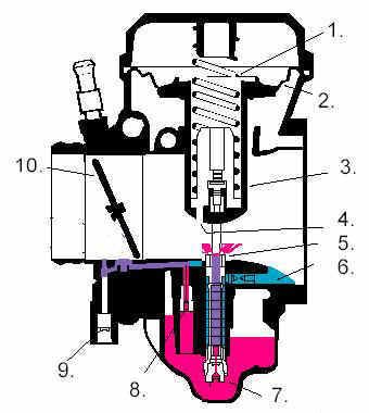

Emulsion tube = needle jet. See item "5" in this generic carburettor:

QUOTE(Pict @ Thu 27th Dec 2007, 05:52 PM) <{POST_SNAPBACK}>
Ah... 'The Generic', now that was one hell of a motorcycle. Seems you could get parts just about anywhere!
